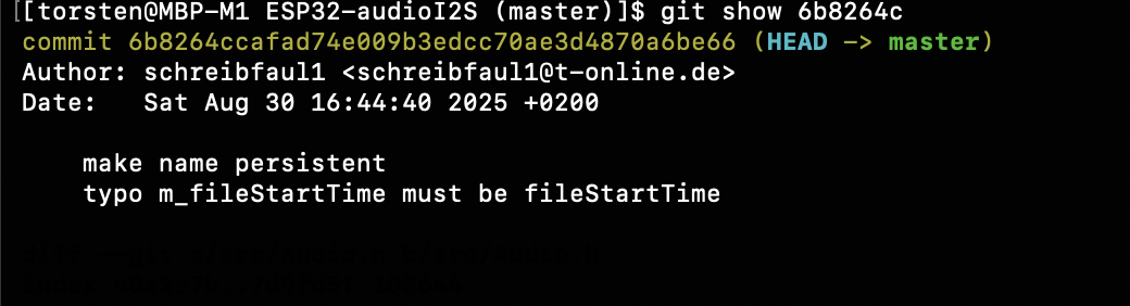

hmm auch die schnelle finde ich den commit nicht in der AudioLib…
Was passiert wenn du das #6b8264c entfernst? nur zum Testen?
Also den Commit gibt’s:

the commits are still there if you go on the web, but if I try to pull them based on the short hash only with git on the CLI, they don’t work.
so I changed the short hashes into the full SHAs and they’re working again, I’m able to build with a current git pull from the repo, with the libraries exactly as the specified commits.
